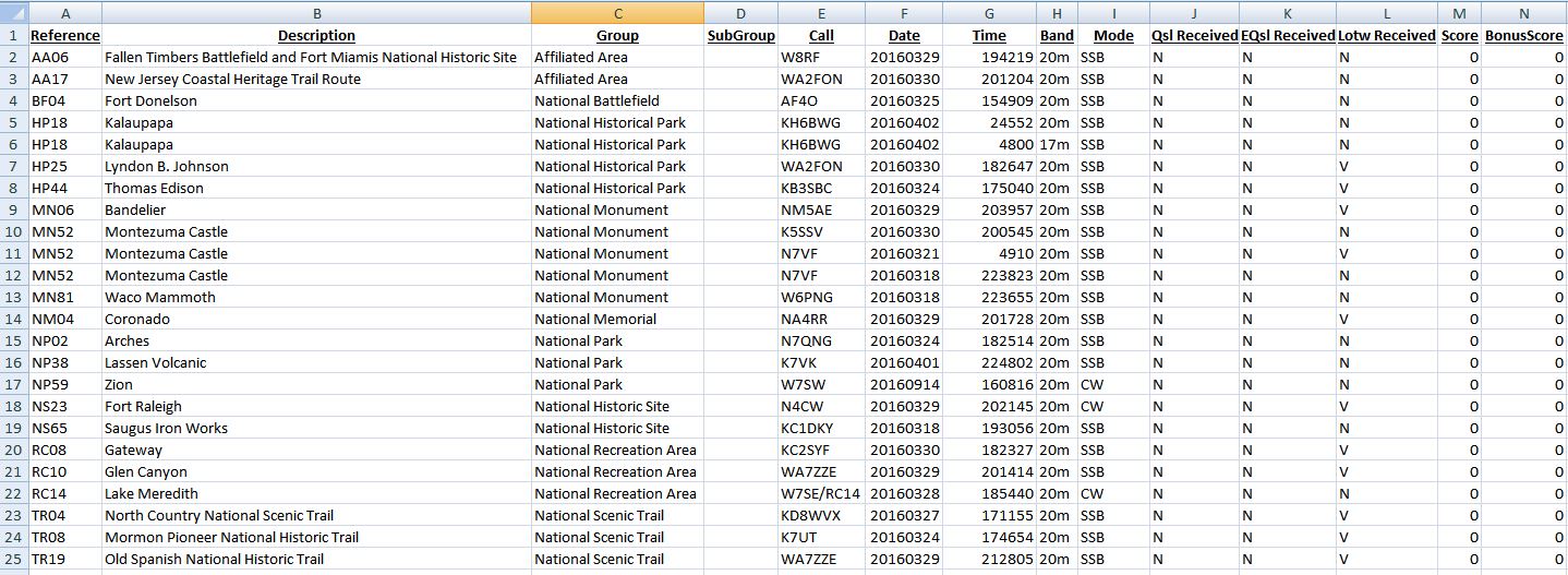

It depends how you saved the NPOTA references?
If you used our awards manager then there are two ways of generating a list and a method to print labels
1. By using statistics and awards and saving to CSV file produces this report

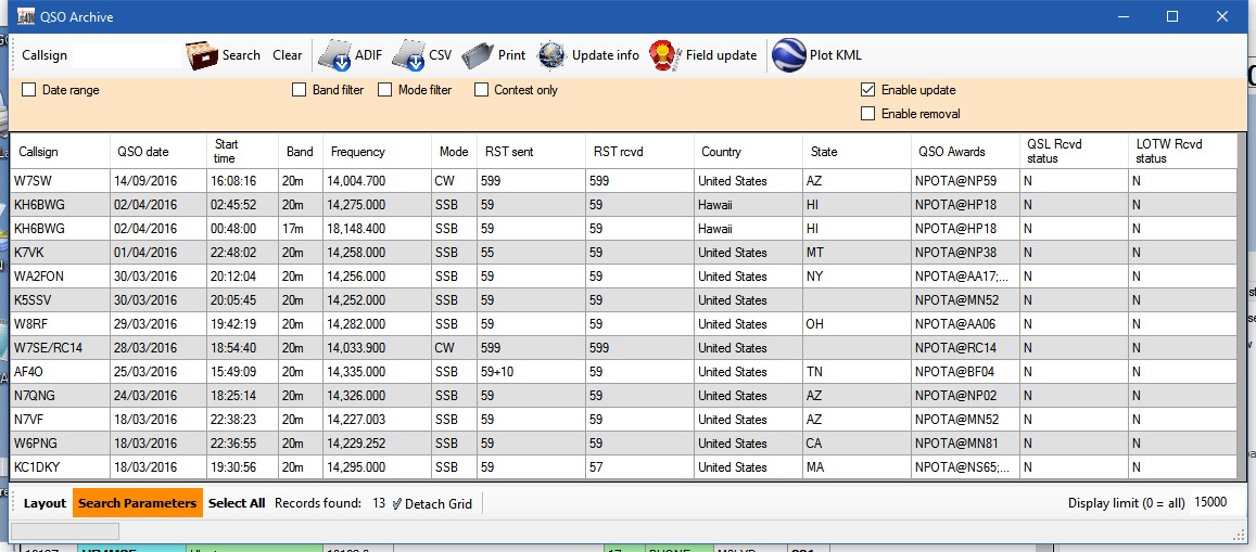

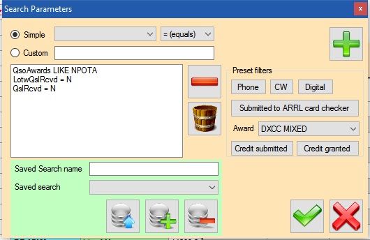

2. By using the QSO archive manager 'Search Parameters' as below
Can produce this report as a csv or an ADIF file

Question -
Where are the 'Saved Searches' stored; in a file or in the database? Is there a way to save them in case I accidentally deleted some (like I just did!!)
Mike / KA4CDN
Posts: 11594
Re: NPOTA, Search Parameters?
KA4CDN wrote:Question -
Mike / KA4CDN
in an xml file in your configuration but it is encoded so of no use to a user
However there is a save and load button and a drop down to select a saved search so you don't need the actual file

Right but I didn't understand the big - button and clicked it several times deleting saved searches. I've done that a couple of times now. Perhaps a confirmation "Are you sure?" would be nice there.
