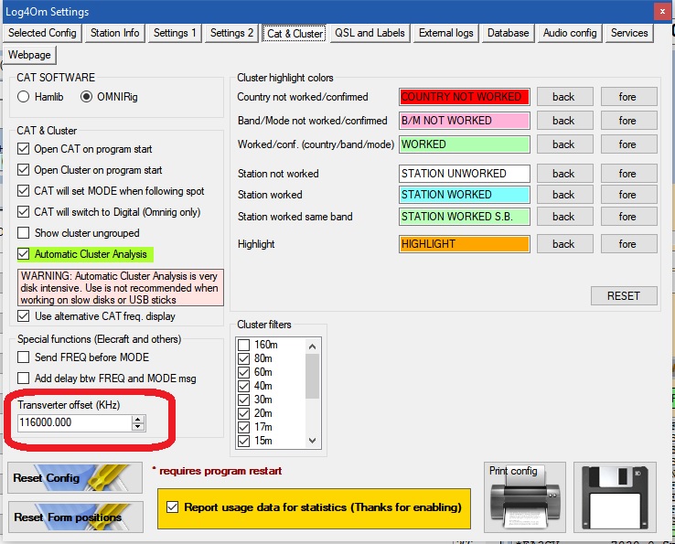

Hi
I am new to the software and I can find no reference to how to use the transverter offset function. I have a TS590SG and I use 2m via a transverter that works on the 10m band. Of course when I use this all calls gets logged as 10m.
I need to be able to add the correct frequency but only when using the transverter.
Is there a solution here?

Re: Transverter Offset
Post by M0WTL »
Thanks for the response and also the excellent software!
I saw this setting but will this looks like a global setting so therefore all but 2m will incorrect. I could not find anything in the manual about it.
Am I misunderstanding the use?

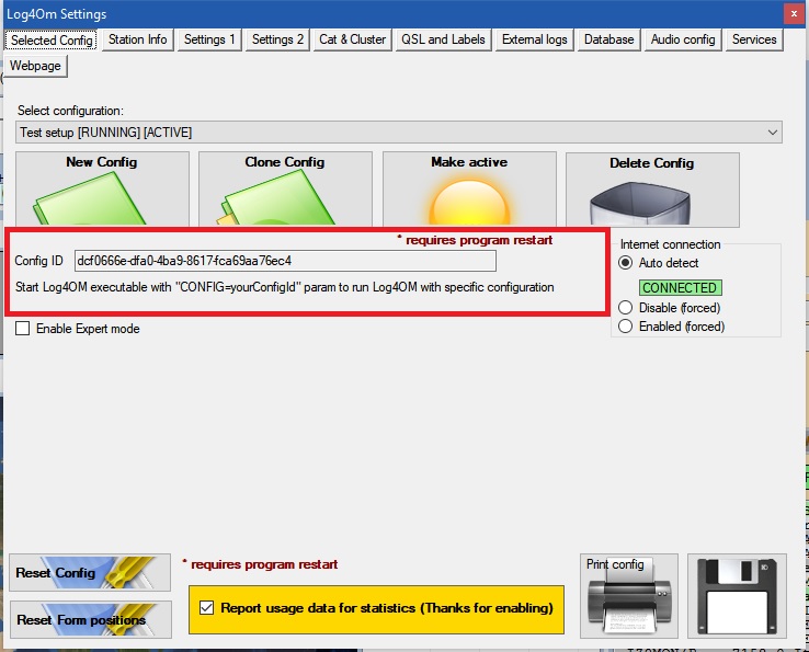

Did you condider using a seperate configuration for transverter use and another for normal operations?
Set up two icons on your desktop for each config perhaps?
Don't forget to use the config ID in the shortcut to differentiate between the two ID's

Post by M0WTL »
Just to update, I have managed to find another solution which might be better than running two versions. This i via Omnirg - I made a new rig profile with an offset and now I can just select rig 2 and I get the correct frequency.
I think your solution is better if you have more than one radio controlled by omnirig!
Thanks for your help

Hi Terry
I am needing to revisit the alternate config idea however I cannot get this to work.
In the shortcut I have this:
"C:\Program Files (x86)\IW3HMH\Log4OM\LogOMUI.exe" -CONFIG=dd671c82-f4d9-45ed-b927-98ac6e846a72
I have tried multiple variants and nothing seems to work.
What am I doing wrong?
Thanks!
M0WTL wrote: 05 Sep 2017, 19:27 Hi Terry
Thanks!
Like this
"C:\Program Files (x86)\IW3HMH\Log4OM\LogOMUI.exe" CONFIG=d08e4e06-c1b1-4904-ae13-4fcecca27abb
Leave out the hyphen (-) before the word 'CONFIG'
