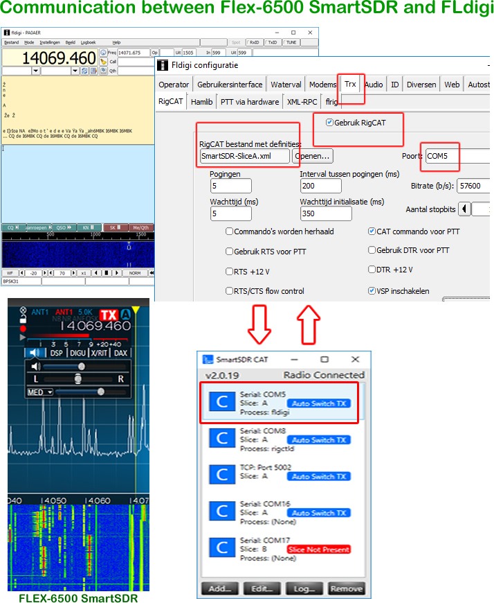

As promissed, this is my setup for the FLEX-6500, FLdigi and LOG4OM. For JT65 and FT8 it is very simular.

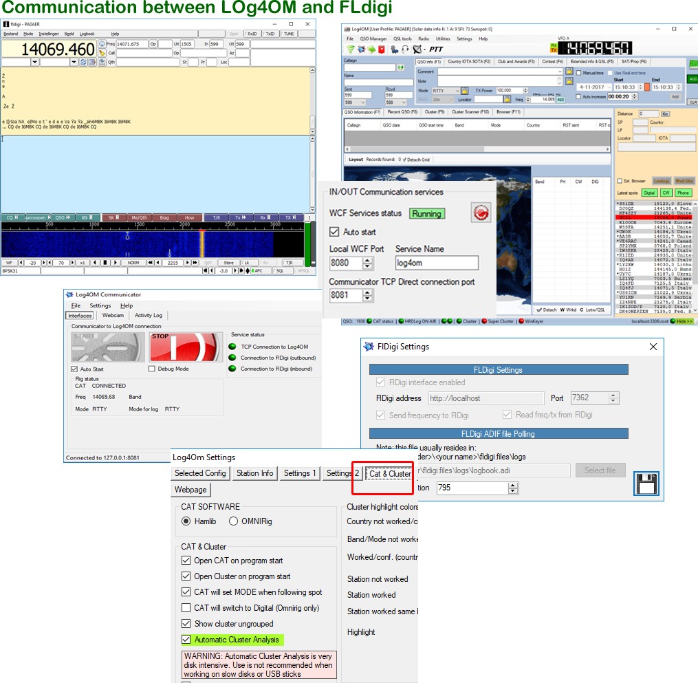

and this is the setup for communication between LOG4OM and FLdigi
