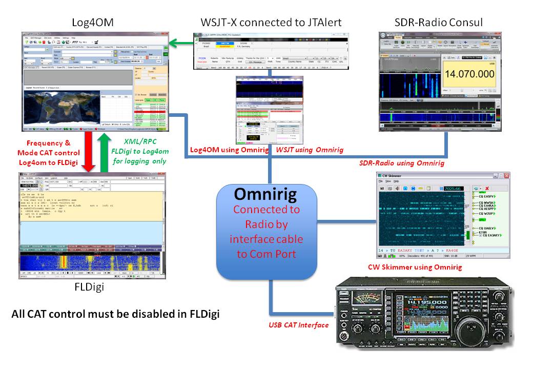

I was trying to integrate fldigi (and later JT65/FT8) but the description in the manual (page186) is differtent with my installation. I can communicatie with other software, have a MySQL database, but do not see settings for the communicator.

Hi Geert,
if you have started Log4OM the Communicator is an own program with it´s own symbol in the
taskbar, it looks like a blue marbel or so. You have to open the communicator and hit the red
STOP button to make the changes you have to setup (like described in manual from page 186).
After setting up you have to hit the START button and you can minimize the communicator to
the taskbar.
Note:
You have to close Log4OM and Flidi now. Now you can restart both programs but you have to
start Fldigi first followed by Log4OM. In the other way it would´t be work.
If you need to integrate WSJT-X also se this thread: viewtopic.php?f=10&t=3138
By the way, as Chuck said, Log4OM must be run with administrator privileges to make all features
possible.
