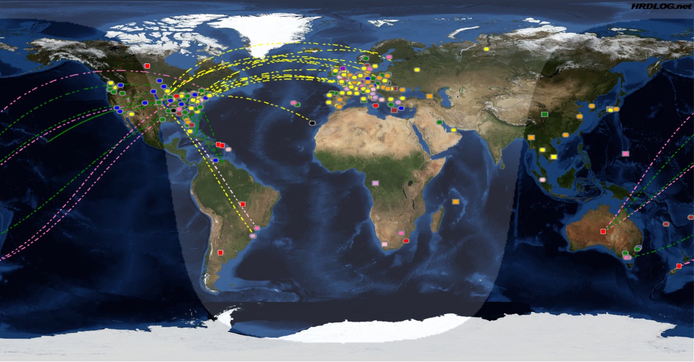

"low resolution" lines coming from HRDLOG are a over impression on the map based by a picture generated by HRDLOG itself.
Those lines shows CURRENT QSO LOGGED in the world, registered by HRDLOG.
The image is useful to show the current propagation based on real QSO made by operators all around the world.
If you select a single band, the mix of colors will be reduced and you will see only contacts made in the selected band

I assume this is an HRD thing but half the dots don't have lines going go them, half are blurry and only a few are ones you can dynamically click.
