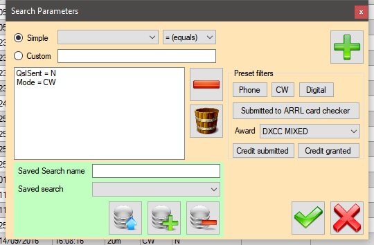

Yes you can update in bulk but to make the list of QSO's more manageable its best to filter first, perhaps as follows:
In the QSL manager select 'Search parameters' at the bottom left of the window and search on
QSL received status = N
Mode=CW (Or mode of the bulk of the cards)
Please not screen grab is wrong it should be QSL Rcvd Status not sent :oops:
Having closed the 'Search parameters' window click the 'search' button at the top of the QSL manager window
Your now left with a list of CW QSO's where you have not received a card
Using the standard windows system of shift/click and Ctrl/click select the QSO's for update
Once selected set the QSL Received, QSL Rcvd by and QSL Rcvd date fields and click the save icon
Repeat process for other modes or perhaps you prefer to filter by DXCC etc the choices are infinite.
