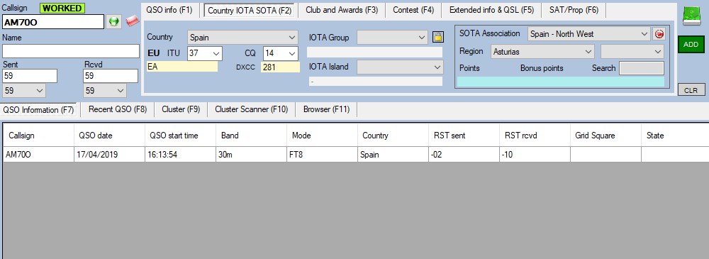

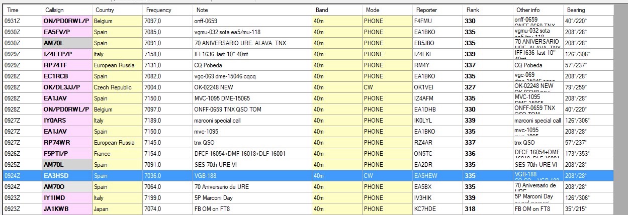

Always with the cluster :
1) My settings is :
2) I'm looking for the AM70 stations
See the line below the selected line
The AM70O
with this cluster interface I see :
I contacted AM70O (call is in Gray)
I contacted Spain ( country is in Yellow)
I Contacted Spain on 40M (Ban is in Yellow)
and
I Contacted AM70O in Phone (the mode is is Yellow)
But I never contacted AM70O in phone mode
where is my mistake?
or how do I display a call that I have already contacted on this Band but not in this mode?
Thanks & 73

Re: Cluster not contacted on this mode
This is because the transmission is in the phone part of the bandplan
There is no designated part of the IARU bandplan for FT8
You can modify the bandplan yourself but be aware that if you do any phone contacts that appear in the area that YOU designate for FT8 will then show as FT8

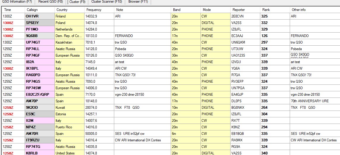

Hi
it's me again, with the same settings
sorry but I'm trying to understand how the cluster display works
for an another example : AM70R SPAIN on 50005 in CW Mode
I never contacted AM70R in CW on 6M but I contacted SPAIN in 6M on CW mode
That means the cluster see that I already contacted SPAIN in CW mode on 6M but NOT about the CALL
So I looking to understand How can I see if I not contacted this CALL on this Mode in this Band ?
Thanks again
PS : I modified my BandPlan : I created a R1_user.xml file
Thanks again

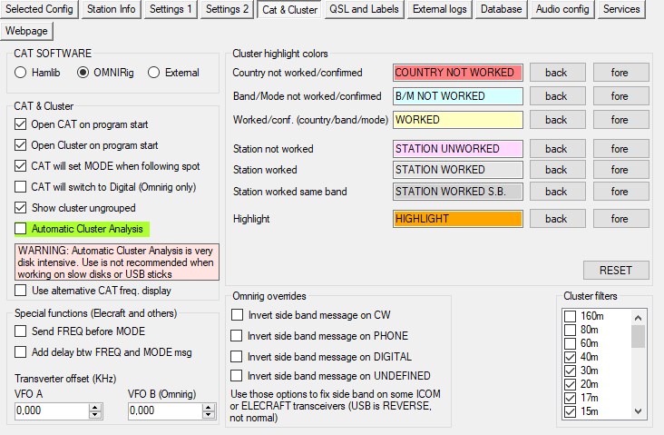

Looking at the way you have your colours set it is working as it should
Light grey highlight of call sign = You have worked that station before on any band any mode at some time
Dark grey highlight of call sign = You have worked that station on the same band (Not necessarily the same mode)
Country highlighted in yellow = You worked that country on any mode on any band at some time before
Mode highlighted in yellow = You worked that country in that mode before
Band highlighted in yellow = You worked that country on that band before
If the COUNTRY has not been worked on the band or mode then with your colour set up it would be highlighted in Light BlueF6FLU wrote: 05 May 2019, 06:21 Yes Terry
that's why I ask the question :
If you read the options for cluster highlights you will note there is NOT a facility for indicating is an individual call sign has NOT been worked on a particular mode! only that it either has or has not been worked on the same band!
Most Hams only look for band slots not to work a particular station on every mode one every band?
You could sort/filter in the QSO Archive window for that call sign and then sort by mode order for making a print out
Or of course you could view the worked before list in mode order when you enter the required call
Alternatively use the filters shown below to list unworked bands and modes
