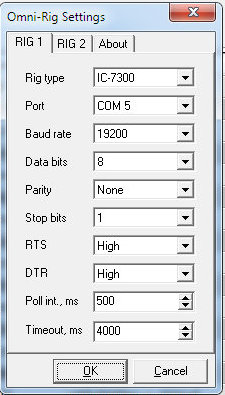

Mauro, this is what my settings look like. Of course your port may be different.
Edited to add: I’m not sharing the comm port or using port-splitting software.

N4IAG wrote: 21 Jan 2020, 17:30 Edited to add: I’m not sharing the comm port or using port-splitting software.
Same here.
If using the IC-7300 for data modes, like FT8, suggest you use the IC-7300(Data) ini file for Rig type. It puts the radio in USB-D mode, which is better.
I also have RTS and DTR set to low, and the Poll int. to 100ms.
