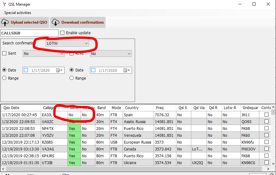

Manually, using QSL Manager, it should be obvious which QSO's have not been uploaded to LotW. The ones marked Sent = No and not in Green background. See below. If you are not seeing this view, do you have LOTW selected?
