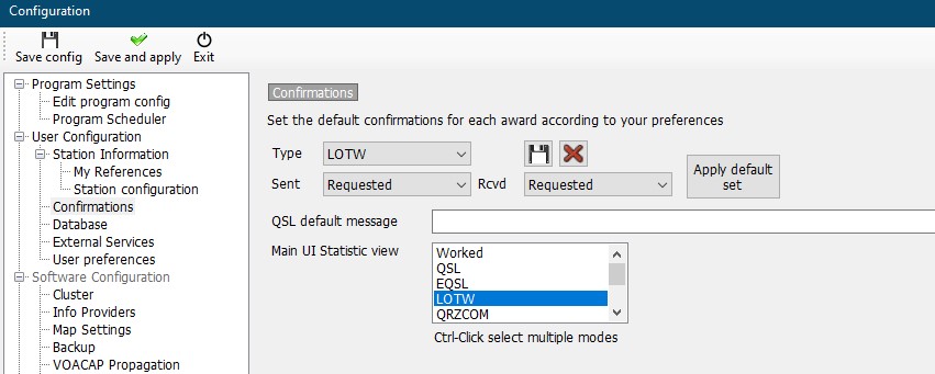

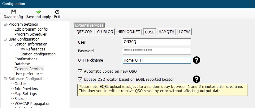

Hello, I am new with LOG4OM V2 but my eQSL is not automatically uploaded. Also download from eQSL don't work. I put my login and pasword correst. Same by LOTW upload and Download don't work. QRZ and CLUBLOG work fine.

pls provide output of the realtime log while uploading.
Help --> Realtime Log
Is your QTH Nickname correct ?

Re: EQSL upload
Roland my QTH Nickname are correct. This my open logfile i check.
73 Pat

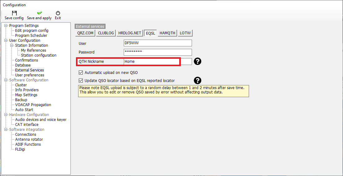

Re: EQSL upload
My uploads to all services are running well. Please check in the "My Accounts" of eQSL your setted Nickname
is correct. If There´s "Home" you have to enter "Home" in the Log4OM eQSL settings. If it´s another one you
have to use these .... Check out for upper case and/or lower case letters.

Re: EQSL upload
Roland i do new install LOTW and the rest upload fine now.HB9VQQ wrote: 31 Jan 2020, 13:39Pat I don't see any upload attempt in your log. Is manual eQSL upload/download working ?Roland my QTH Nickname are correct. This my open logfile i check.
