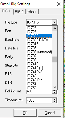

OM,
Using OmniRig (make sure you have the latest OmniRig version and latest rig ini file downloaded), there are 2 IC-7300 files to choose from.
Example:
