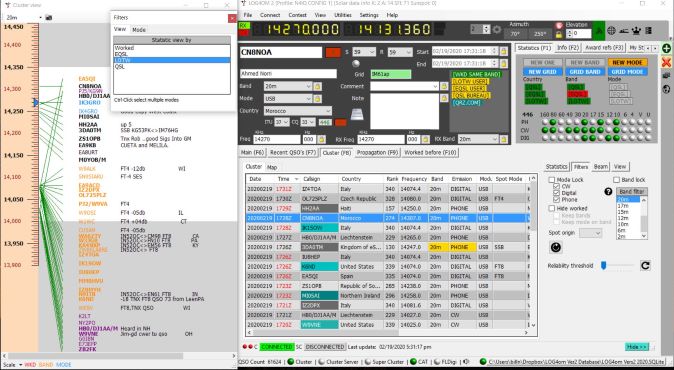

The cluster bandmap status bars are not showing as I would suspect. See screen shot. In this case I have previously selected LOTW but bars are not showing for Worked or any of the other confirmation methods, as well. I should be showing status bars for almost ll the stations showing - the statistic screens show I have worked most of these countries on this band and the modes showing.
I must be doing something wrong.

Perhaps I should be looking at the bars differently - maybe the bars show a "needed" status; not what I already have. ??? The Guide was not real clear on this - at least for me.

I am pretty sure now that the bandmap status bars shows you what you need. I have been doing some more checking. Because I have 339 countries and almost have Challenge Level 3 (I am bragging but it is pertinent to this discussion Hi), I have worked most of the cluster spots -band and mode, showing in the bandmaps. In the past few hours, some status bars are starting to show. In checking those status bars and my log/statistics, I need those particular stations because of either mode or band. So if you need a lot of countries, country-bands- or country-modes you will see a lot of status bars in the maps. But if the reverse is true and you have a lot of confirmations in your log using the various confirmation methods, you will not see a lot of status bars. I am almost (98%) sure this is the case after doing the checking. Having the status bars show NEEDed versus what you have already done makes a lot of sense to me. The needed calls/ countries/band/modes will stand out immediately - otherwise you have to search through a lot of already worked status bars.
