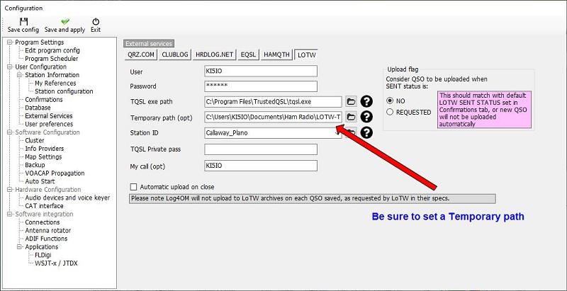

Double-triple check your logins and passwords. No special characters are allowed. See Page 79 of the current User Guide.
Also ... make sure the Temporary Path is filled in at: Settings / Program Configuration / External Services / LOTW
Screen clip below is of my configuration.
