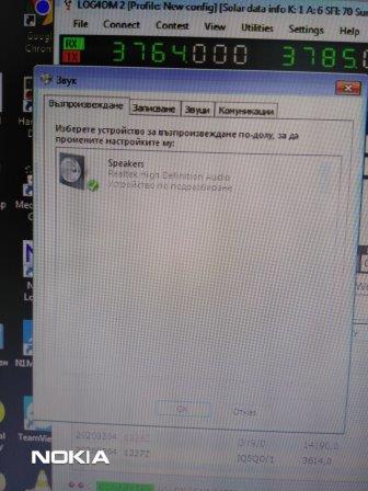

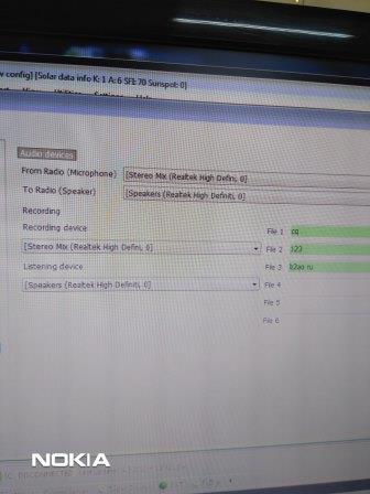

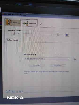

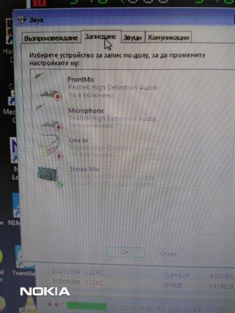

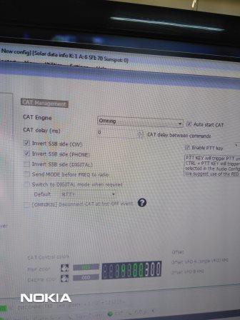

Hello,is there anyone with Yaesu FT dx3000,who uses voice transmition (Log4om v2) to help me with the settings?

i have a ftdx 3000 and i have try the voice keyer too but i have the same problem
if you put your trx on data usb you can see that the audio go on the air but if you are on usb or lsb nothig only the ppt is active but no audio.
It is the same here i have try with other software and it is working but not on log4om i think it is a software problem not a hardware.
just save your configuration on turn your trx on data usb and you can see all is ok
so it is not a problem of audio configuration
i have try with many software and it is working on usb not necessary to go on data mode the problem is only in log4om
