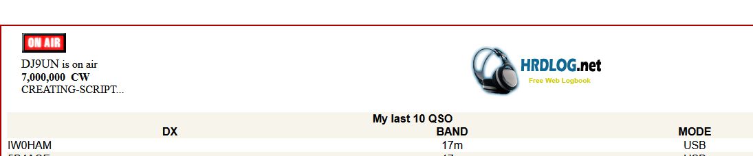

DJ9UN
Posts: 38
Joined: 01 Jan 2018, 09:45
Re: HRDLog On AIR status
Post by DJ9UN »
I am using Log4om V2 2.27.1.0
Settings in erxternal datas are made to automatic swich HRDLOG ON AIR
CAT is working FTDX 5000 MP and USB interface SCU 17
In HRD i can see i am online but wrong Frequency, always 7000 CW
I copied the Scriped and copy into QRZ. There i see the same.
I wonder what is wrong. Thank you in advance for any suggestions
