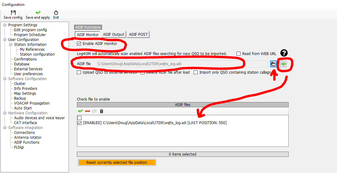

Instructions for logging from JTDX into Log4OM V2:
1. Log4OM V2 - open Program Configuration - ADIF Function tab.
2. Check Enable ADIF monitor
3. Click on folder icon and search for the wsjtx_log.adi file in the JTDX folder under User\<name>\App Data\Local\ folder. See below.
4. Click on the + tool.
5. Make sure you end up with the Enabled file path and file name as shown in the example below.
6. Click Save and apply at the top.
Note that the logging into V2 is not instant, as its a scheduled scan of the adif file. But it works fine for me.
