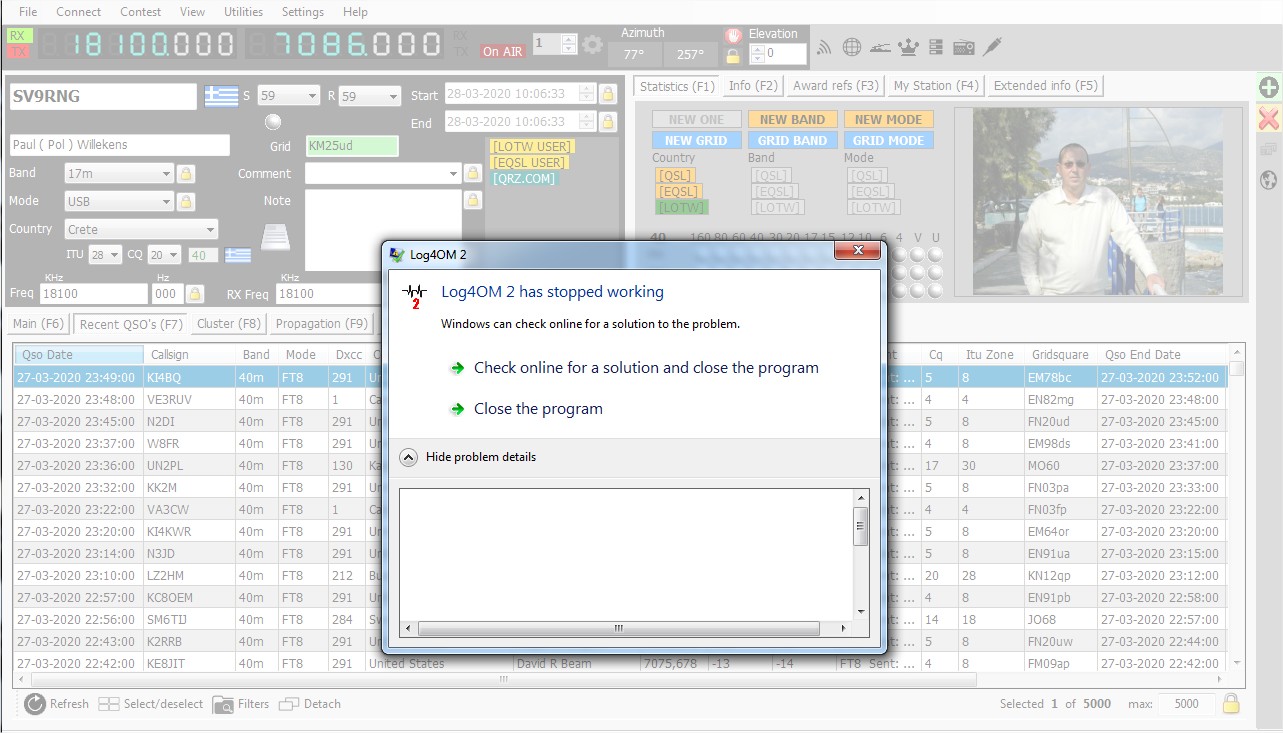

A few days ago the Log4OM stopped working.
Now in the last days, keeps crashing and crashing...
Nothing was changed in the station computer, not even updates, but no joy!
I decided to post here this because just a few minutes ago was twice in a row.
What can be done to sort this problem?

I would suggest a CLEAN instal having first backed up your log and having made a copy of your config.json file located in the c:\........\appdata\Roaming\log4omng\user folder

This is not the best approach/solution to me!
That's my log at risk!

CU3ED wrote: 17 Apr 2020, 10:25 Hi,
DF
Nothing is at risk if you backup first!
The most likely cause of your problem is a corrupt file this way you start with a new clean set of files and you just use your original config file to restore your settings

OK I will clone the entire disk, just in case!

Before uninstalling,Try using a different com port interface if your old one is based on an FTDI or alike USB interface. Sometimes windows updates don't cause trouble... :D
