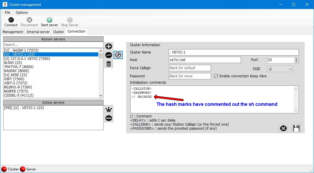

Im still seeing old spots staying on my cluster from 1 hour or more. I am using ve7cc. I need help fixing this. How do I remove the sh/dx/30? will this correct the problem?

Mike,
See image attached. I just used a couple hash marks to comment out the SH command. This has solved a number of issues. If you do a search here on the Forum you will find several conversations about the sh/dx/30 or whatever value that can be used.
You have to disconnect the cluster then select it and push the edit button, make the changes, save it and then remove from the edit panel and finally reload it to be your primary cluster and then connect.
The SH command just forces (in your and my case) the VE7CC cluster to pull down spots for a quick display and many might be old or just aged an hour or two or so.
I just like the cluster to start showing the calls when the show up without being pushed through the gate.
I also do a fair amount of filtering on the CC User APP for ve7cc and a couple other clusters that I try now and again.
I try to keep things set up primarily for CW visibility. I'd have to dust off my mic as it has been a long time since I used SSB and I occasionally work some FT8, but mostly for testing V2.

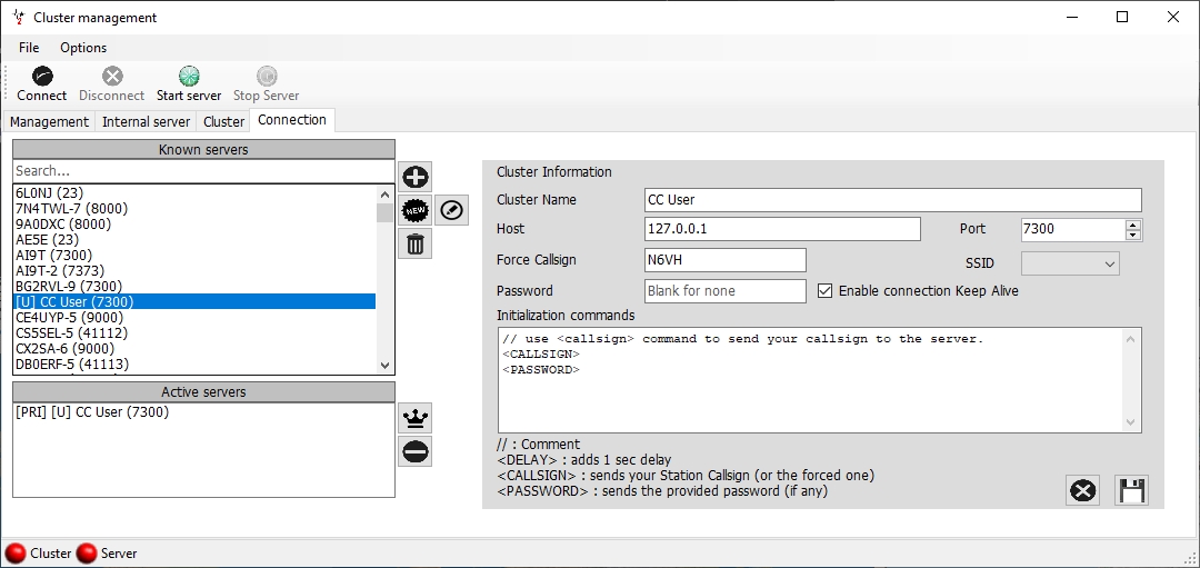

Nolan,
I have the same problem. Here is a picture of my cluster settings. The sh/dx 30 command isn't even there, and hasn't been for quite some time. When I first start CC User, I get spots from spotters from our west coast. Then, when I connect to CC User with Log4OM, it still apparently sends the sh/dx command, even though it isn't in the configuration.

N6VH wrote: 20 Apr 2020, 20:50 Nolan,
Jim N6VH

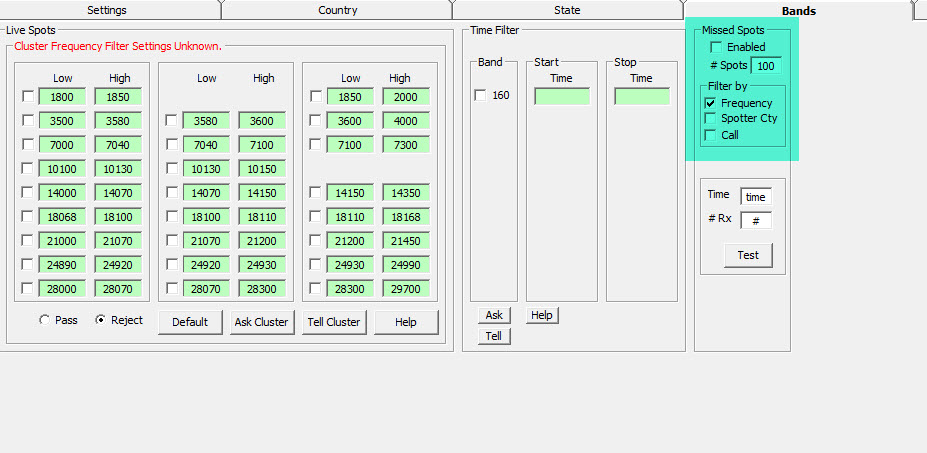

Jim, take a look at CCuser.
Under bands there is a setting for missed spots. I think it essentially does the same thing as sh/dx. I might be wrong but give that a try please.
Rich

Rich,
Yes the missed spots box was checked. However, that isn't the problem. I unchecked the box, and still getting the same results. Here is the text from my most recent login from Log4OM to CC User:
