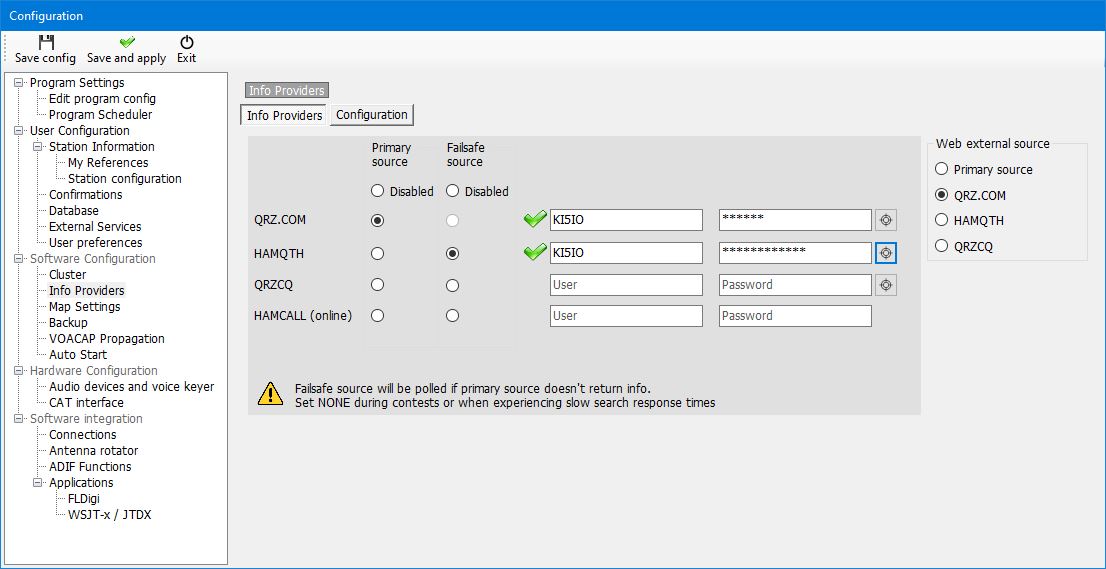

Yes, looking at QRZ I see your membership. That should get you the 'data' points as long as you are using good login/password from within Log4OM V2. Clip below is how I have my V2 set up for the Information Providers. QRZ is my first choice and HamQTH is my roll-over choice. I've switched them on/off now and then for testing, etc..
There is a 'test' button to the right of the password field where you can verify your login/password is working. If you get the green checkmakr then your link to that info provider is alive and well.

Nolan, he emailed me earlier and has it resolved.
The check box for QRZ.com was not checked as shown on your above image. So you were spot on.
