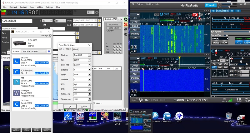

hi,
still no luck with latest log4om second vfo. Here is my setting window.
Rigs: FLEX-6300 Ant: 6 band hexbeam (by SP7IDX).

Re: Frequency Display
With the Flex, you can add a second rig in OmniRig after setting up another serial port in SmartSDR CAT. You can toggle between those two but I have not been able to get the Flex to work with OmniRig VFO A/B config.
You can also use HamLib instead of omnirig and using Slicemaster the Log4om frequency will change based on active slice.
