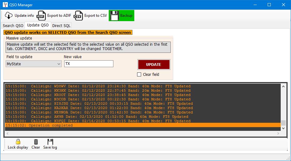

I just replicated your steps (sort of) and did a change of over 1900 Q's.
- I created similar filter for MyState <not equal> TX.
- Added filter to box and closed the filter window and window automatically refreshed (I did not tap refresh).
- I clicked on Select/Deselect to select all Q's found via the filter.
- I then clicked on the Update QSO Tab
- I then selected the field to update from the dropdown: "MyState"
- I entered in TX for the new value.
- Then I tapped the "Update" button.
- Process began and update was successfully made.
I think you missed a step in the process. Screen clip below shows portion of results following the process I noted above.
- QSOBulkUpdate.JPG (100.93 KiB) Viewed 1990 times
