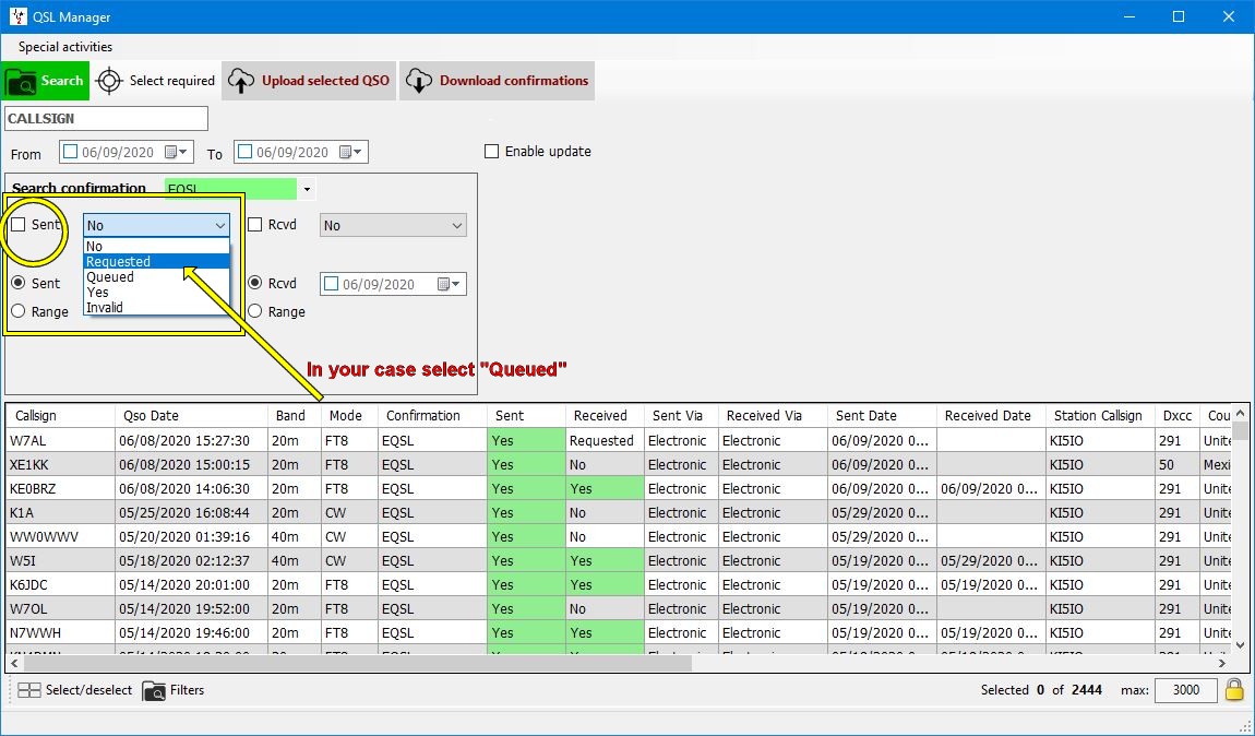

Dave,
Now that you have change the labels in the Confirmation area for the External Sources you will also have to make some changes when you are in QSL Manager.
When you do a search or Select Required you will need to tic the "Sent" box and use that drop-down and select "Queued". That should then find the Q's you are wanting to upload.
Once they are uploaded The QSL Manager routine will change the Sent box to "yes".
Give that a try and see if that helps.
