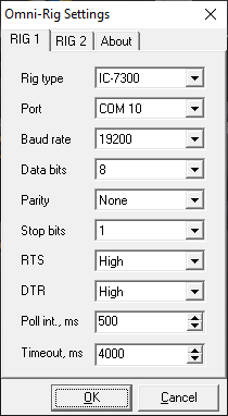

EA7BYN wrote: 09 Jun 2020, 18:30 Can you share with me your Omnirig setup?
Sure. There you go:
