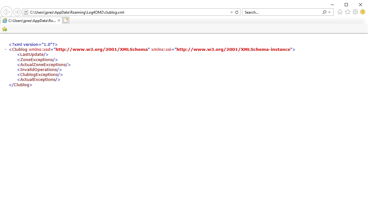

Is the Clublog Exception list in the clublog.xml file? If so, mine doesn't have anything in it except for this (see attached picture):
I had just done an "Update Resources/Clublog" to check, and it's still the same. The file is only 1 kb. The clublog.xml file that I have in Log4OM v1 is 12798 kb.
I am using Log4OM 2.8.0.0 and Win 10 1909.
Jim N6VH

I just tried doing a clublog update with Log4OM v1. The file that was in the configuration folder for v1 was dated 4/22/2020. After the update, it still has the same date, even though I got the message from Log4OM v1 that the file was updated. I then moved the clublog file from the folder and did the update again (still using v1). The file did not get placed in the config folder. I then went to v2, moved the clublog file from the config folder, and did the update. In this case, the new file was placed in the folder, but still only 1 kb. There might be two different issues at work here, but the important one (to me, at least) is that the file in v2 is basically empty.

That was fast work. I just saw your message about the Clublog issue. I made the correction, and it worked fine. Keep up the great work.
