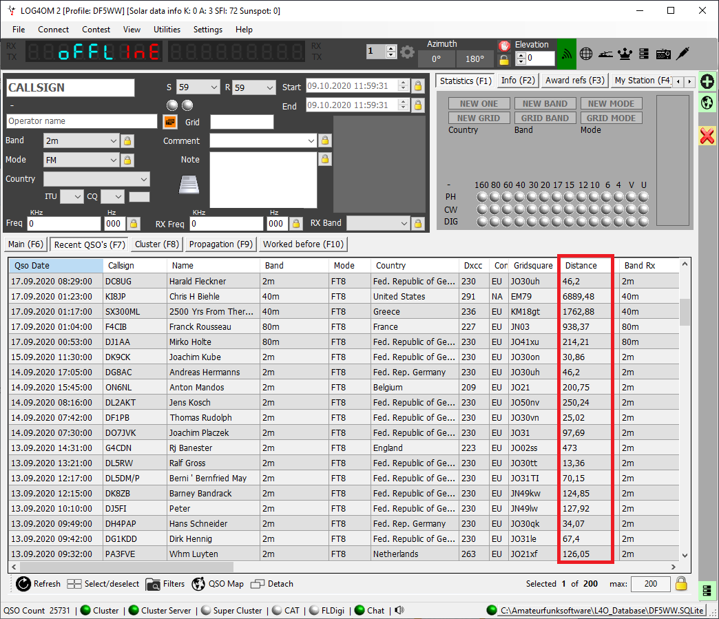

Hello Marc, distance calculation is working fine for me as you can see in my attached screenshot.
There must be something wrong in your setup. By the way your Grid must be set in the options
and you must receive a Grid from any source. Without a grid in the fields the distance will be show´n
0 ....
0 ....

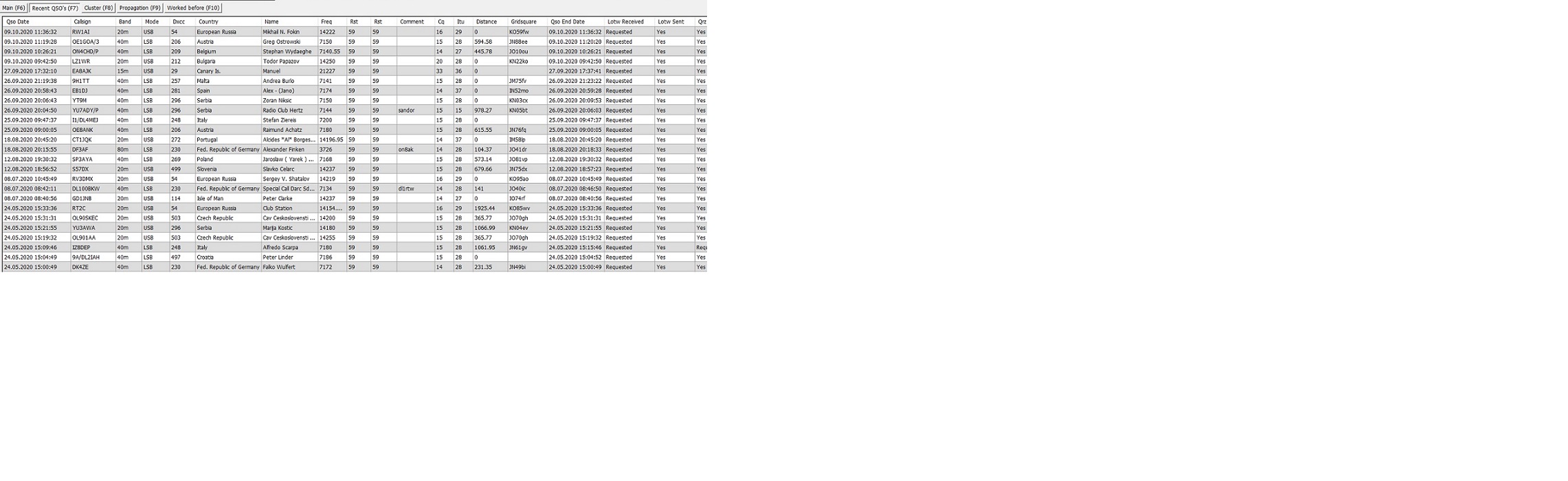

Hello Juergen DF5WW, I entered the grid in my settings, it worked in the past. But if I move the map out of the 1,000 km radius, the display of the distance goes to zero. I've added a screenshot. Unfortunately I'm at a loss ... Thank you very much, best regards, Marc
