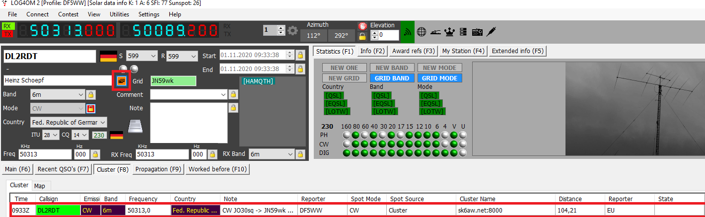

Hello OM,
my actual LOG4OM2 2.9.0.0 does not send out cluster spots when i hit the orange button besides the field for Operator name.
As far as i remember, before last update, sending spots after QSO, then clicking the green cross (or return key) for finalizing QSO was always sufficient.
My spotted QSO´s did always appear in cluster lines below after a short period.
Any ideas?
Wonder whether the problem is on my side of the keyboard or not ;-)
Thanks in advance, 73 de Heinz, DL2RDT

Terry tnx for reply.
What you describe is exactly what i am doing.
But there is no reaction on my clicking the green send-SPOT-tick.
And former, say one, two months ago, this has always worked satisfactorly.
Any further ideas?
Cluster settings, restrictions from cluster... ??
73 de Heinz, DL2RDT

Hello Terry, Jürgen,
i solved it.
It was another cluster which was mistakenly set and it gave me no access due to missing password.
Actual, via EA6VQ, it is running again.
Thanks for your effort, 73 de Heinz DL2RDT
