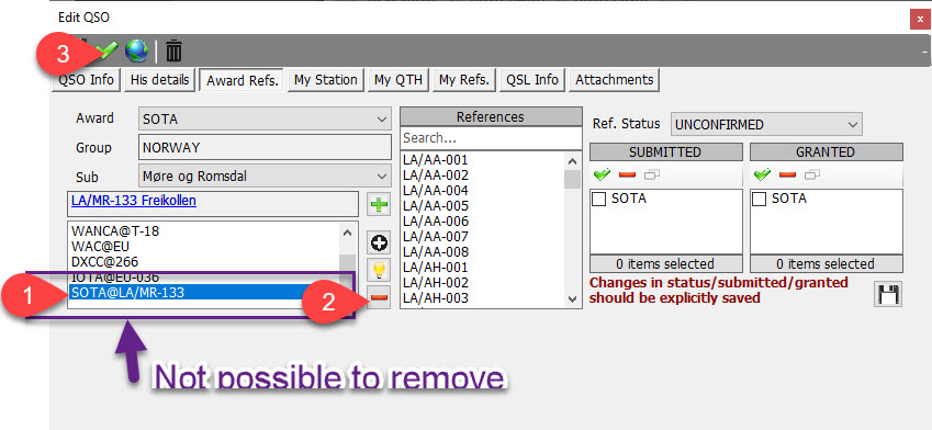

the issue is the same also in version 2.9.0.0
I can't remove the Award Reference

LB4MI wrote: 30 Sep 2020, 16:22 Hi,
(I tried to upload a video at 2 megabytes to show the issue, but get error message that file is to large)

Hi Helge
the COMMENT field of your QSO contains a SOTA reference.
During QSO save the whole QSO is parsed for references (that could be related to newly added awards) and the reference printed on the COMMENT field is identified again, and then reinserted in the QSO itself.
Remove the comment, then the reference and save

thanks for the reply and your e-mail on the same topic,
I've cleaned up all of my comments now, and that did indeed solve the problem!
I was not aware of the "power" of the Comment/Note field for looking after references, but now I know
