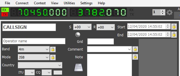

I raised this sometime ago when V2 was first released, is it possible to change or default the JS8/MFSK8 RST format in V2 to be the same as JT/FT modes? At the moment it is still preset to 599 format.

You can edit the rst.xml file which is accessible via Help/Open Config folder in Log4OM and having edited it save it as rst_user.xml so that it does not get overwritten during the next Log4OM update.
Simply add a line
at the top of the list in this area <string>JS8</string>
</RstValues>
</RSTItem>
<RSTItem>
<GroupName>JTx modes (JT*, ROS*)</GroupName>
<DefaultForModeType>false</DefaultForModeType>
<ModeType>DIGITAL</ModeType>
<Modes>
Restart Log4OM and selecting JS8 will provide the correct default RST values

Many thanks for prompt response, I remember having to change it in V1 but did not realise you could also make the change in V2.
All works, much appreciated support.
