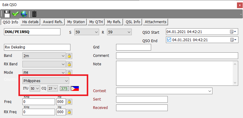

Re: Incorrect Country being logged
Made some test loggings but both show´ n as Phillipines in the lookup and in the log.

DF5WW wrote: 04 Jan 2021, 04:47 Made some test loggings but both show´ n as Phillipines in the lookup and in the log.
how weird is that..... thanks Juergen... I will do a reboot ans see if this helps
