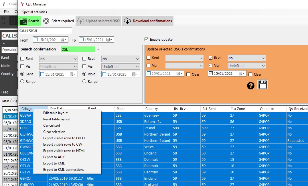

QSL Manager filter as below
1. References tab set Award to IOTA /Reference (Leave blank)
2. Confirmations tab leave Search confirmation blank but select RCVD to No and check the box
3. close filter dialog
4. Select all
5. Right click on a title field and select an export of your choice
4. Select all
