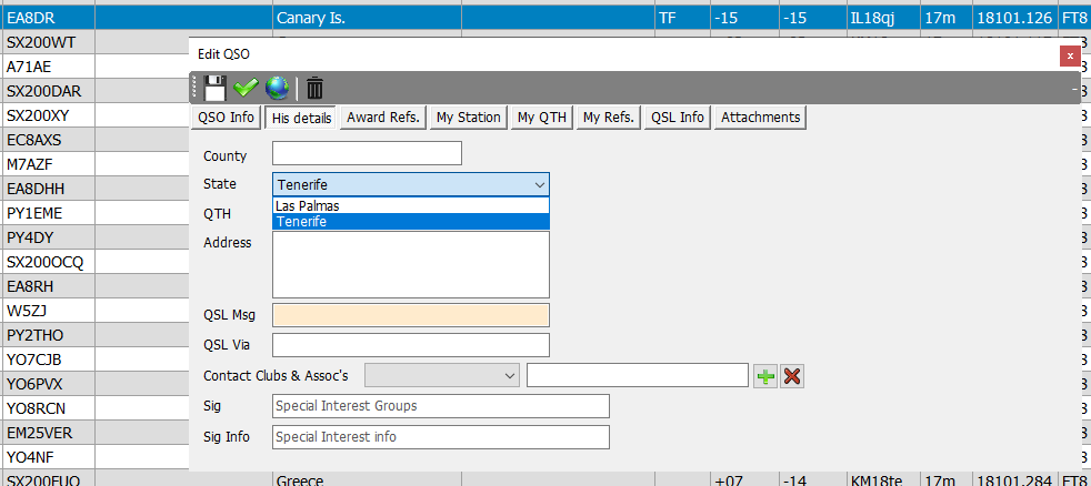

I imported a WSJT .adi into Log4OM v2.11
The station "EA8DR" appears to be in the State of TF, in the QSO detail, the State drop down contains Tenerife or Las Palmas, unable to change to Blank
There is nothing in the original .adi that I can see to cause this, it shows TF in Log4OM adi
I have checked other "EA8" QSO's, the State is "Blank", But the drop down shows: Tenerife or Las Palmas
Thanks... 73 Dave

I just did a test QSO using WSJT with EA8DR and the QSO was transferred to Log4OM with nothing in the state field even after a QRZ lookup so I dont have a clue where the state came from unless it was originated by HRD also?
The drop down only shows two possibilities eg Tenerife or Las Palmas but if you dont select either or save the edit the field will remain empty. We include these choices in case there is a WASP (Worked all Spanish Prefectures award) at some time in the future.
When we export an ADIF we export exactly the data in the logbook so if state field contains anything it gets exported
Remedial action
To remove the state go to the QSO Manager
Select the QSO
Select the 'Single field update' tab
Select the 'State' field
Check the box 'Clear field'
Click 'Update' button
That will resave the QSO with an empty state field.

G4POP wrote: 01 Mar 2021, 16:08 I just did a test QSO using WSJT with EA8DR and the QSO was transferred to Log4OM with nothing in the state field even after a QRZ lookup so I dont have a clue where the state came from unless it was originated by HRD also?
Remedial action
Select the QSO

I have looked at some other EA8's... They are O.K
This one is only a few days old direct from WSJTX .adi file... I have not used HRD properly since 2015, a few QSO's entered 2018..??
I have spotted a few other STATE anomalies, an old UA9MA with "OM", State drop down contains lot's of Departments/Regions..??
Will try your fix ASAP
Many Thanks.. 73 Dave

G4POP wrote: 01 Mar 2021, 18:25 See my comments and reflect if it's really an issue worth wasting time on?
Hi Terry,,
It's done...
In the QSO Manager I dragged the State Field next to Callsign, sorted on State... I was able to fix 18 quite quickly...
I hate bad data... A cast off(habit) from my previous life :)
