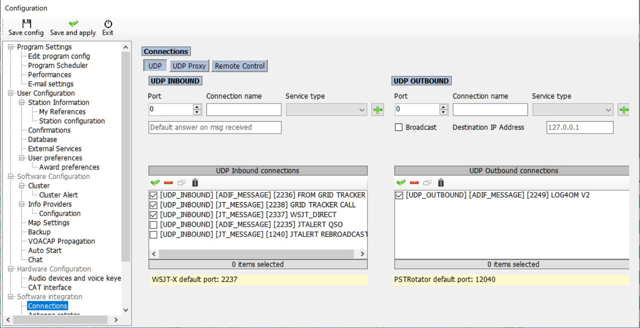

I reviewed the manual and still cannot get the callsigns to populate the callsign field in Log4OM. My connection tab is below. Maybe a trained eye can spot any conflicts that I'm not seeing.
Re: FT8 callsigns not showing up in callsign field
Mike,
Take a look at this OM's configuration. We've recommended it a number of times.
https://www.k0pir.us/gridtracker-wsjt-x-and-log4om/

Post by NT6X »
Hi Nolan,
Thanks so much for the link. Everything is working great now.
Mike, NT6X
