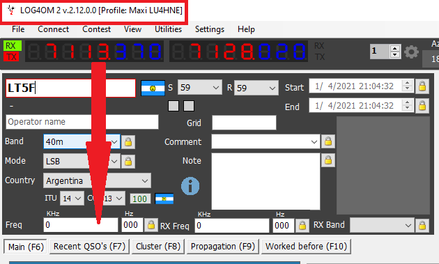

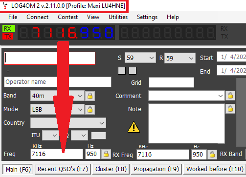

Download the latest version and now it allows you to see the 2 vfo but when registering a contact it does not copy the frequency in the log
frecuencia 2.11.png (18.19 KiB) Viewed 3793 times
In version 2.12 it correctly shows both vfo but it does not copy the value in the contact, even when saving it does not copy the value either.
disable
frecuencia 2.12.png (23.48 KiB) Viewed 3793 times
My Rig is FT-890
this option new "VFO mode" parameter no make change if enable or disable
