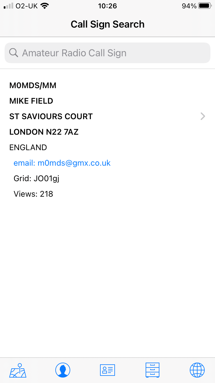

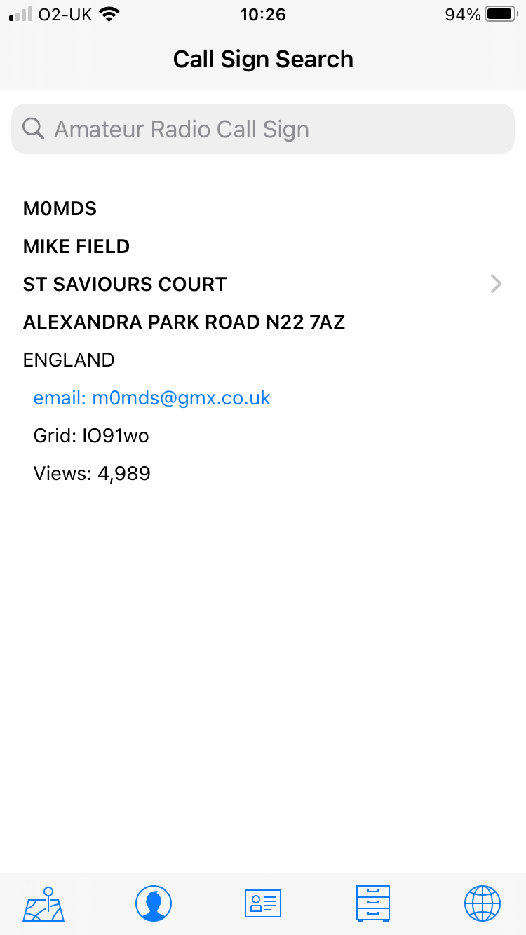

An xml query of QRZ does give a country and a locater see below.
M0MDS
M0MDS/MM
M0MDS

Log4OM reports no country for the /MM but does report the IO91wo location which isn't quite right.

No it is not I sail the north sea and as soon as I leave the river I am considered to be at sea according to ham radio, not maritime law which includes the 3 mile limit
Of course it does but it's reflecting the entry not the DXCC rule
How does QRZ know when your in the middle of the Irish sea if your outside the UK coastal waters
Official description
"The following notes are made with regard to the UK "Full" amateur radio licence terms, provisions and limitations, and so may vary slightly from other amateur licences.
Maritime mobile operation is defined as operating a transmitter that is located on any vessel at sea. This means any manned structure afloat outside of the high-water mark. Operating on vessels on inland waterways is defined as mobile working, and so requires /M to be added to the callsign, not /MM as for maritime mobile operation."
