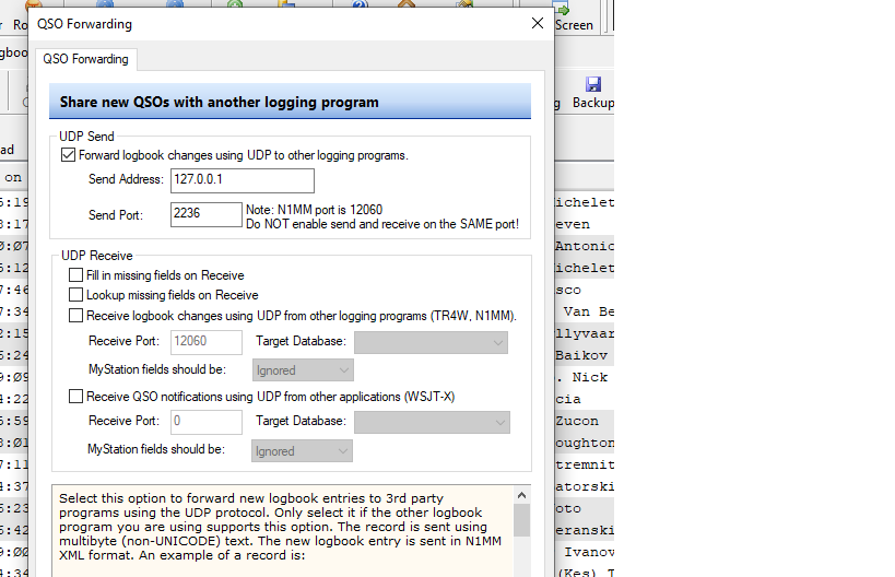

Hello everyone.
Using hrdeluxe only for digital connections, I would like to be able to use the possibility with the udp ports to import with the "qso forwarding" the qso file in log4om, wonderful program, but I can't.
I assume you can't because of the diversity of databases, is that correct?
Thank you
nicola

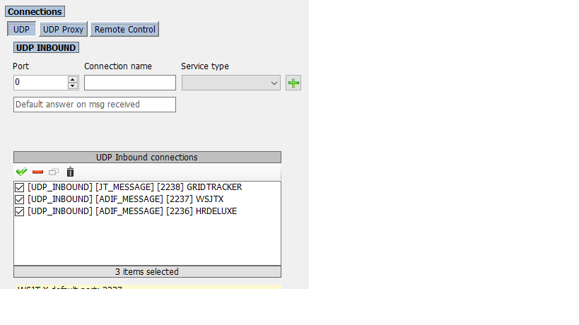

Yes DF5WW it's possible...
log_hrd 1.png (44.33 KiB) Viewed 2873 times
but what am I wrong or what I forget..and attention, only the two programs concerned are active, hrd and log4om.
Nicola
Nicola IW3GCR
Re: Qso Forwarding from hrdeluxe to log4om
Could be possible that HRD send the new Log entry in the N1MM XML format as describet in the Box below
the HRD UDP settings. Log4OM is waiting for standard ADIF data. That´s only my Idea, maybe we have
another guy here which uses HRD for digitals and have it work.

DF5WW you are completely right !!!
All the best.
Nicola
