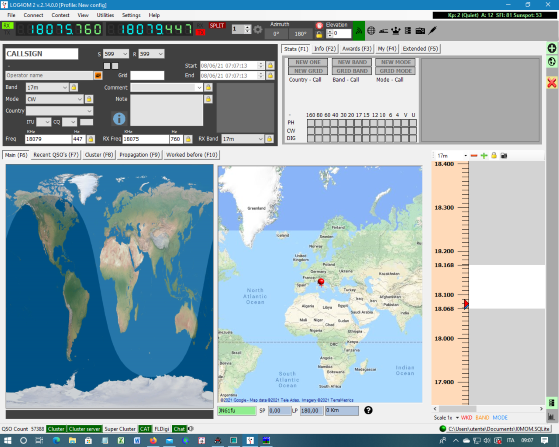

IC-7800 and omnirig LOG4OM Display only 1 freq.
