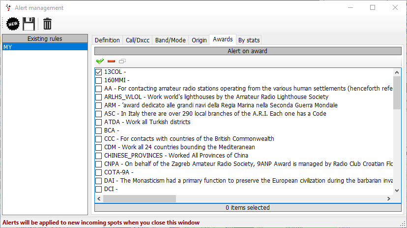

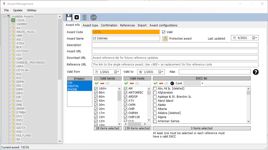

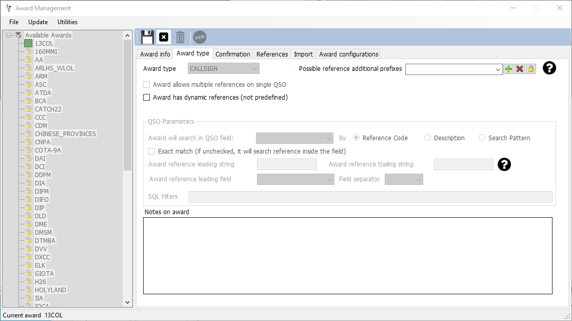

I created a rule that should match a selected award.
When I spot simulate with a call included in the reference awards it does not alert.
Some detail about the rule:
By stats = Ignore.
Call/Dxcc
DXCC = All
Callsign = I iterated thru using a specific callsign thru wildcard and no callsign at all.
BTW Just a plain rule without award works fine.
Any limitations or specific issues using awards as a rule criteria?
73 de N5HC
/Conny

N5HC wrote: 04 Jul 2021, 14:38 I created a rule that should match a selected award.
By stats = Ignore.
Call/Dxcc
DXCC = All

Using release is: v 2.15.0.0
Have User Guide dated: 02/07/2021 1:25 PM, (and read/searched it)
Did read thru page 74 thru 76 and I do get simple rules to work based on DXCC/Call signs etc.
However those pages does not specifically address awards.

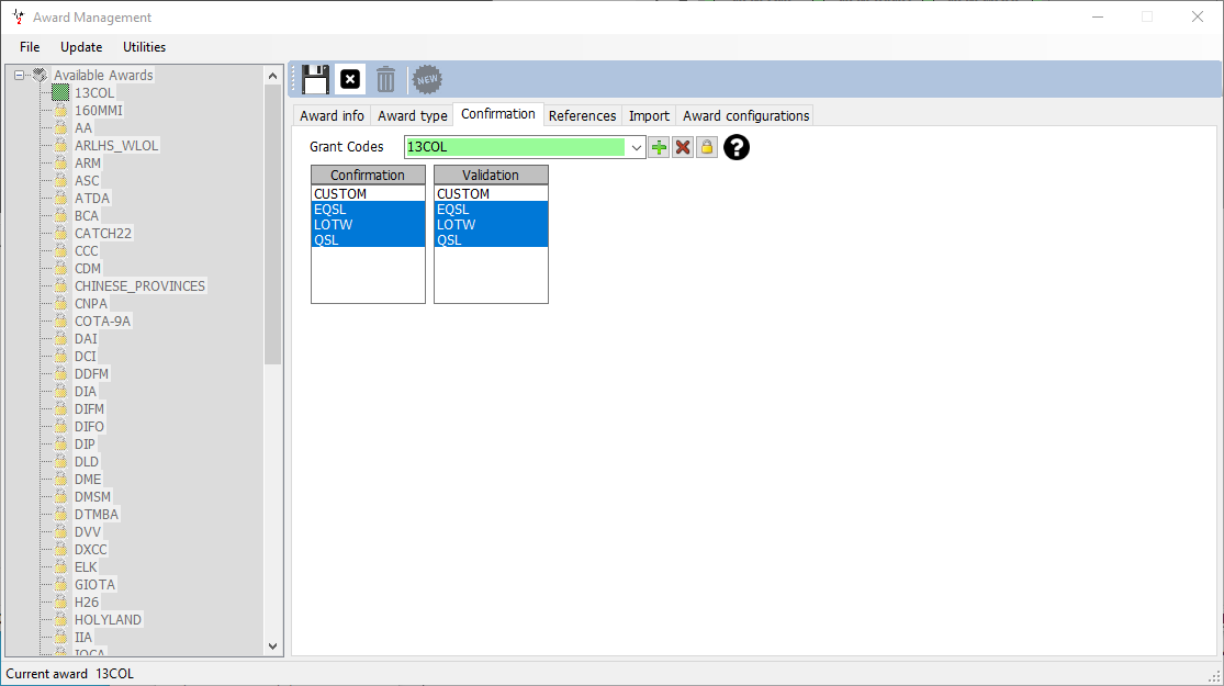

Attaching screen clips.
Screenshot 2021-07-04 090005.png (27 KiB) Viewed 4130 times
Screenshot 2021-07-04 085950.png (33.16 KiB) Viewed 4130 times
Screenshot 2021-07-04 085921.png (23.78 KiB) Viewed 4130 times
73 de N5HC
/Conny

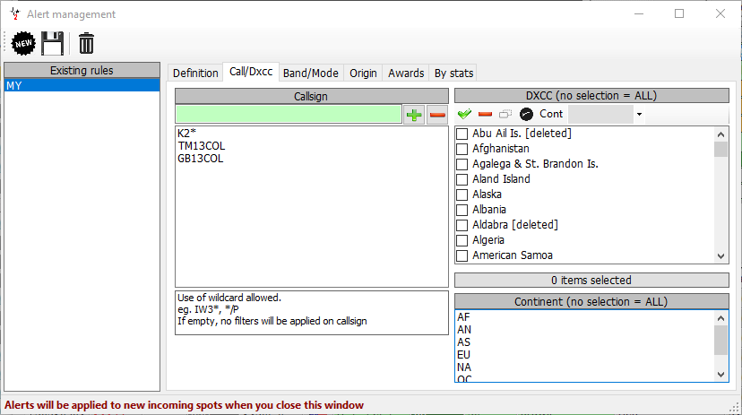

Screenshot 2021-07-04 090103.png (31.62 KiB) Viewed 4130 times
Screenshot 2021-07-04 090046.png (41.28 KiB) Viewed 4130 times
Screenshot 2021-07-04 090022.png (28.91 KiB) Viewed 4130 times
73 de N5HC
/Conny

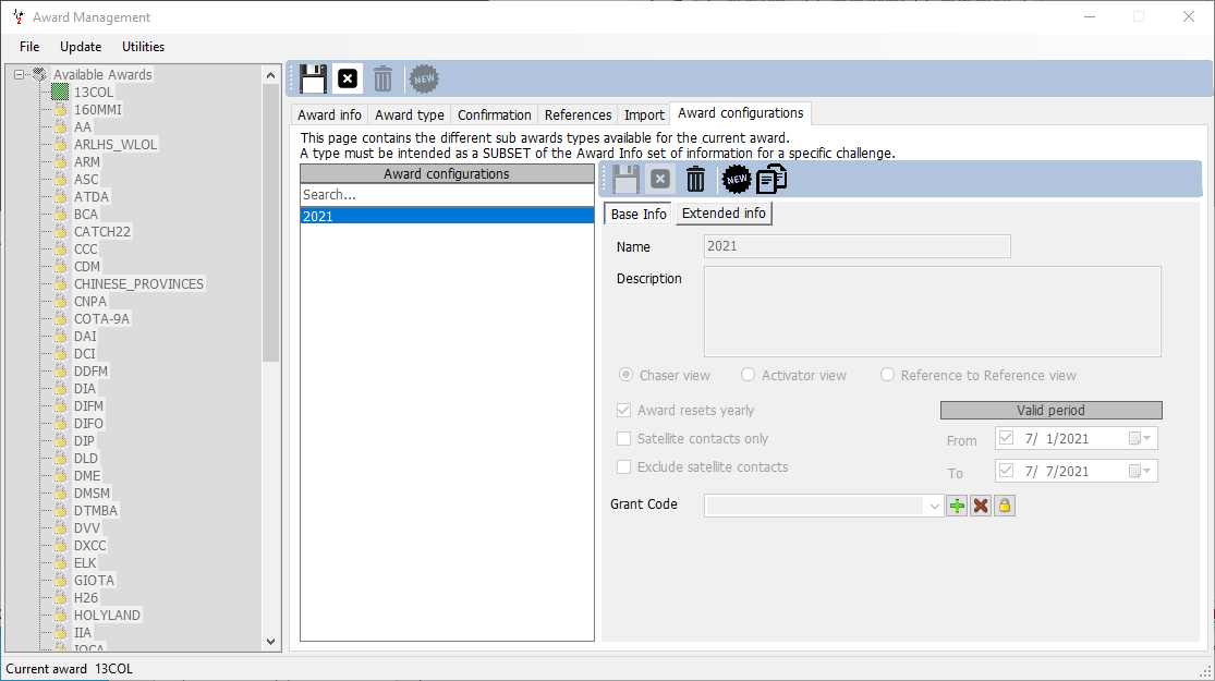

Screenshot 2021-07-04 090217.png (50.45 KiB) Viewed 4130 times
Screenshot 2021-07-04 090203.png (65.57 KiB) Viewed 4130 times
Screenshot 2021-07-04 090146.png (79.4 KiB) Viewed 4130 times
73 de N5HC
/Conny

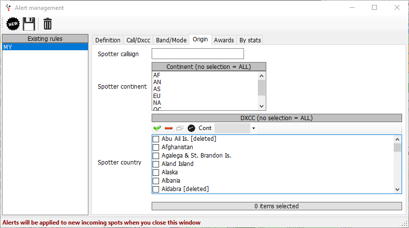

N5HC
Posts: 20
Joined: 02 Jun 2019, 14:06
Re: Award Allert
Post by N5HC »

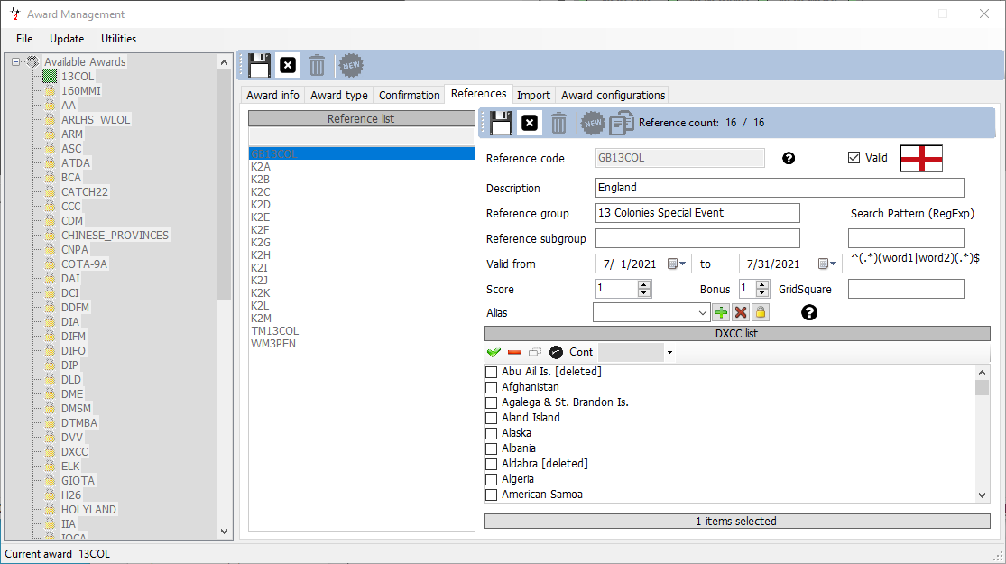

Screenshot 2021-07-04 090326.png (69.1 KiB) Viewed 4130 times
Screenshot 2021-07-04 090249.png (78.42 KiB) Viewed 4130 times
73 de N5HC
/Conny
