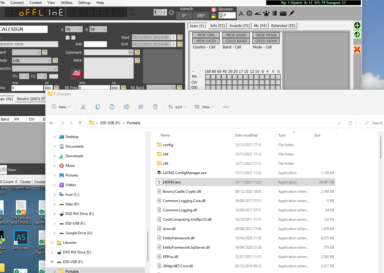

Hi Terry, thanks for assisting my efforts to get this running.
I can understand your comments about the benefits of putting the database on the cloud, However it is not the issue for me at this stage... I have desktop version running on my laptop and desktop machine but I still cannot get a clean install of the portable version to work.
From the info from Jeurgen, DF5WW, I have now downloaded the Portable 2.18 version, unzipped it to a thumb drive (clean install NOT an update) and tried to run L4ONG.exe both in the old laptop and my base station I7 PC. both running W10.
The desktop version of LOG4OM runs fine on both computers but the portable version does not run on either. ( Also tried "run as administrator") so I guess that the machines software environment is suitable, unless the portable version requires some software that the desktop version doesn't; otherwise perhaps someone can check if all the files that should be in the zip file are actually there? Something isn't right.
Am I missing some step in the procedure?
Do you know if anyone else has managed to get a clean install of 2.18 working on a thumb drive?
Cheers
Bob

Bob,
Sorry I did not respond yesterday but I was at the hospital all day.
However this morning I have downloaded version 2.18 from our web site and un-zipped it onto a memory stick.
I then ran the L4ONG.exe file and was welcomed by the set up screen which I filled in and then created a new logbook on the same memory stick whereupon the program ran as normal, see screen grab below:
I did not bother to set up CAT control but I am confident that it would also function!
My best guess is that something is blocking your files being run from the memory stick, like defender, virus software or firewall.

Hi Terry
Checked my antivirus and found a problem.
During extraction of the zip file the antivirus suspects an executable and sandboxes it.
I re-extracted with antivirus turned off and works fine.. but sloe.. from the thumb drive
Many thanks in helping to get to the bottom of this issue.
72"'s
Bob
