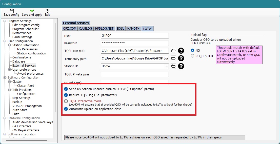

What have you got checked in the config as below?

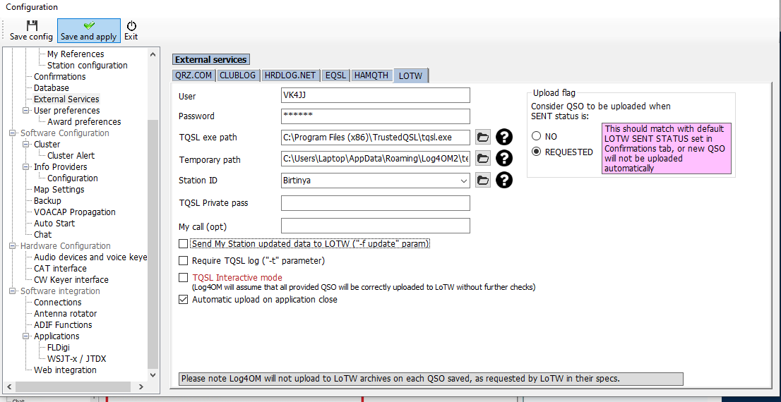

This goes on for a long time, checking the flags.
Please find attached my settings.
I've updated them to match your settings, G4POP, but with the same errors.
