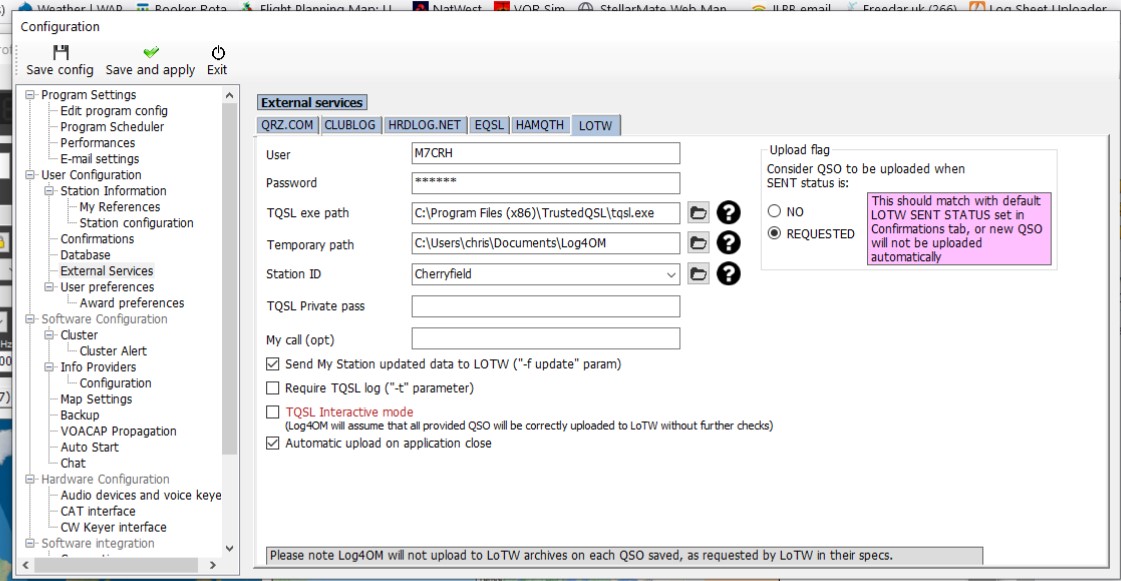

My best guess is that I've not got some part of the set up correct but I'm not sure what. I've attached the LOTW External Services page.
I'm not sure what should be set, the user and password are set to the ones provided on the callsign certificate message from the LOTW people.
The executable and temporary paths are correct, and the log shows action with these.
Not sure what else I can try, I've misunderstood something somewhere, but what?

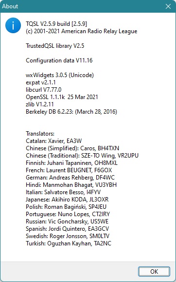

TQSL is version 2.5.9, TrustedQSL library V2.5, Configuration data V11.15

Make sure that you have the latest TQSL build, library and config installed as per the image below
Set the temporary folder in the External services/LOTW tab to C:\Users\YOUR USER NAME\AppData\Roaming\Log4OM2\temp and try again

Thanks, tried that. no difference. Log4OM still hangs and needs closing using the Task Manager.
