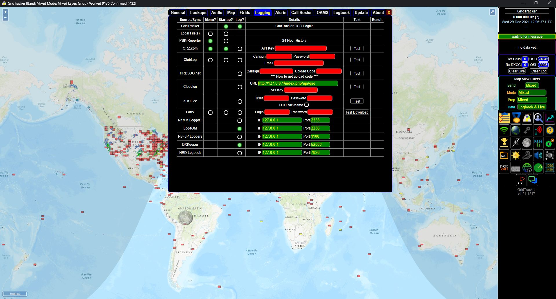

Hello Terry,
the qso's are to LOG4OM via Gridtracker see screenshot.
Tnx Rien, PA7RA
Tnx Rien, PA7RA
- Clipboard01.jpg (246.84 KiB) Viewed 2723 times
Re: Gridtracker Uploading QSO'S?
I cannot see the screenshot well enough to understand it however try NOT sending from Gridtracker but use the UDP method described in our user guide to get the QSO's direct from WSJT
If you set up as described in our user guide using UDP the QSO's will be uploaded to the on line logs as they are worked
