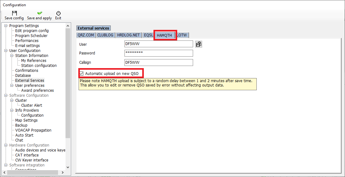

Re: How to use logging to HamQTH
Hello OM (no name in your signatuere),
how you have settet up your uploads in the Log4OM setup ? If you have settet it up to automatic
uploads and you use JTalert the contacts will be uploades around a minute after the contact was
logged.
That means that Log4OM does manage the upload after receiving an ADIF message via UDP.
If you have checked the "Automatc Upload" in Log4OM and you try later to upload an ADIF
you will get an Error.
So first of all, go to the HamQTH account and check your log there. If the contacts are
stored all is fine if not ask again.
