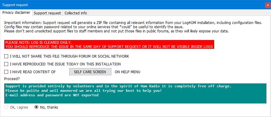

but where do I find a place to get to: Help / Generate Support Request? I looked everywhere
Re: size of logbook
Phil,
Screen clips to get the the Support Request.
Go to: Help / Generate Support Request
Then the Support Request window opens up. Follow the instructions and submit the request to: lele(AT)pisto.it
