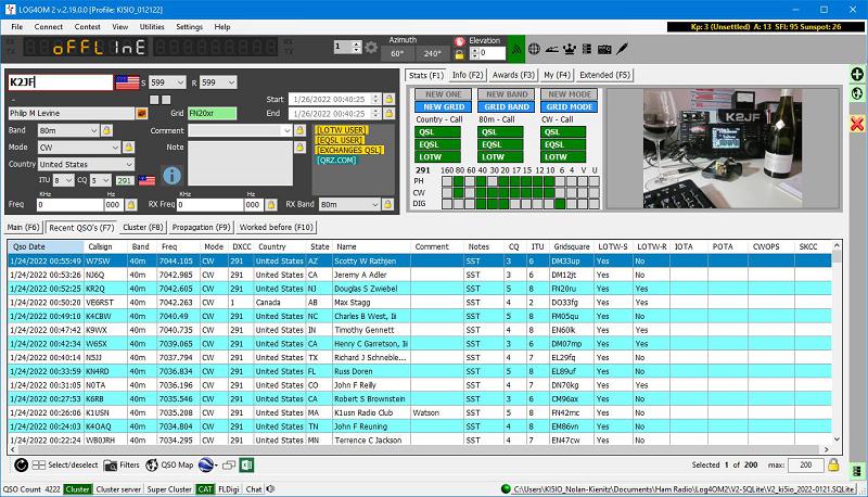

I'm not understanding exactly what you are asking. If you have the Main UI open and selected Recent QSOs (F7) there is no way for that 'logbook' to encroach/cover up the callsign field in the Main UI.
Screen clip below is what my installation looks like with the recent QSOs logbook tab selected.
I'm sure I'm not grasping what you are looking at or needing. Some screen clips would be extremely helpful.
- RecentWSOs_MainUI-medium.JPG (112.98 KiB) Viewed 2028 times

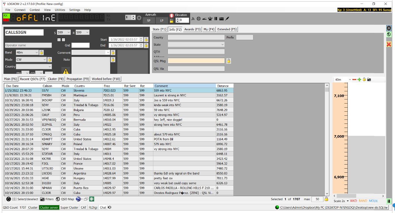

I was having trouble doing a print screen so I saved it in word. I hope this shows what I mean

Phil,
I have absolutely no clue as to how you are able to make that happen. There are not any toggles, switches or setups to even allow that to happen with normal use of Log4OM V2.
Also ... I see you have V2.17.0.0 installed. The most current release is: V2.19.0.0
Are you running Log4OM V2 in or on a Windows PC? If so what O/S?
The screen clip I provided is what a normal screen will look like. There is no way to collapse the panel tabs and have that lower panel overlap the upper Main UI section.
Download and install V2.19.0.0 and see if the installation will help correct something that looks to be messed up.
I've made a screen clip of what you sent me and have added it to this post.
- k2jf_MainUI.JPG (165.54 KiB) Viewed 2024 times
Re: size of logbook
Hi Nolan
I downloaded the new version and still have the same issue with how the log appears.. I'm attaching what I just got after the update.
PRINT.docx
- (187.38 KiB) Downloaded 152 times
