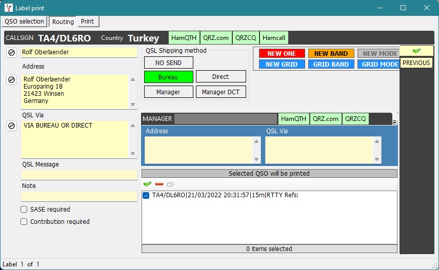

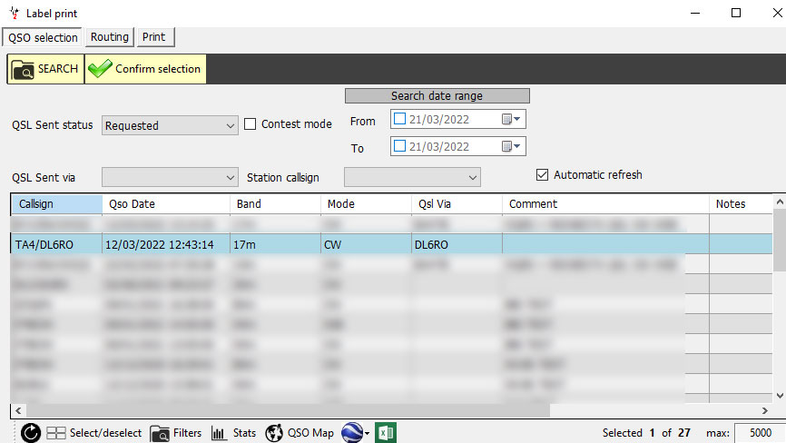

When I select one (or more) logged QSO, for printing label, which has the "Qsl via" field filled
I'm expecting to find the data in the field "QSL Via" in the following step instead of find it empty
Am I doing something wrong?
73 - Maurizio IK4OMU

Dont know where you did your lookup but that call sign shows 'Via Bureau or Direct' and is displayed in te QSL via box OK here

G4POP wrote: 21 Mar 2022, 20:35 Dont know where you did your lookup...
I filled the "Qsl via" data before saving the QSO into the log, adding that information to those of QRZ.com lookup.
Re: Label print - missing QSL manager
IK4OMU wrote: 21 Mar 2022, 21:21
OK got it the manual entry is not being used
Thanks for spotting
QSL via is a field that is filled by QRZ and/or user, and it's updated by default from Log4OM.
actually there's no way to identify an user written information vs externally retrieved info, so by default the field is cleared and refreshed with new data.
I must think how i can identify user data from automatically filled data
