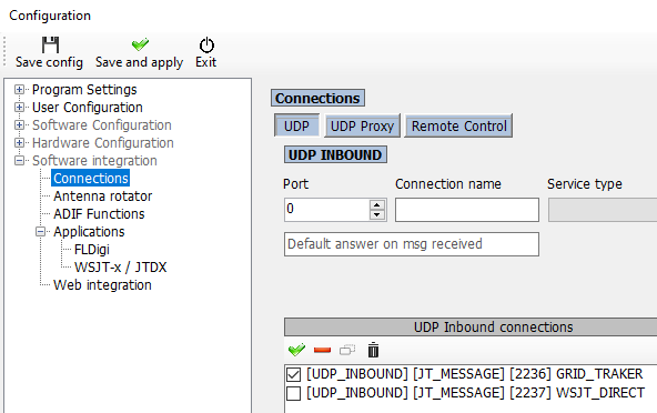

Found to log the ft8 contact, use the service type JT_MESSAGE for the UDP Inbound connection. This will allow for logging the contact in Log4OM.
I unchecked the WSJT_Direct message, but left it there so I could easily go back to the previous set-up.
