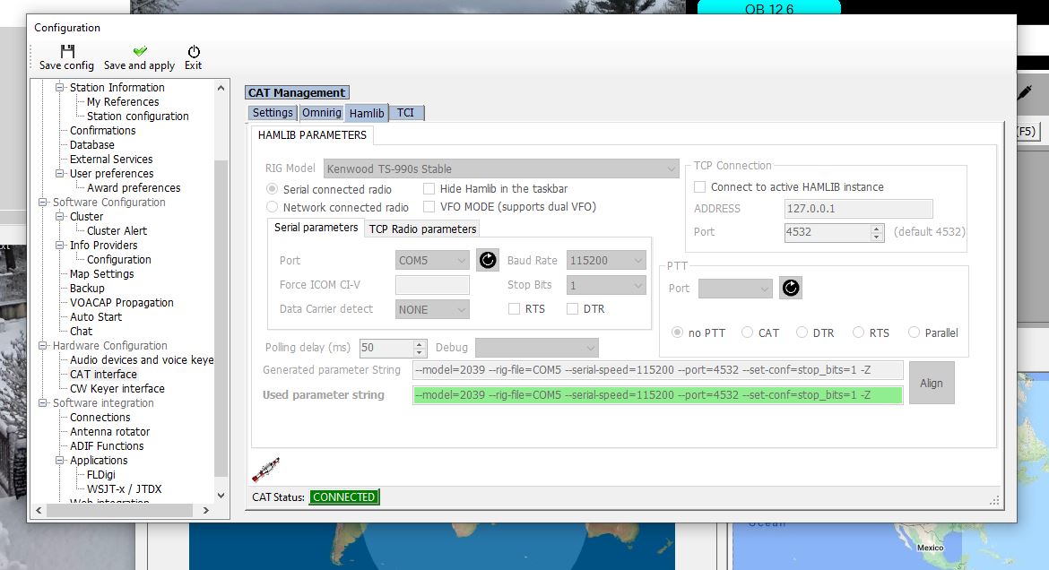

V 2.21.1.0 seems to work ok for me Manuel.
In my shack the TS-990S runs on a USB port (COM5) at 115.2 kb and I duplicated those settings into the Hamlib tab (on the CAT Management config page).
Then I went to the CAT Management Settings tab, selected Hamlib as the CAT engine. Saved this new configuration and then exited and restarted Log4OM. Radio connected fine and appears everything is working as it should. (However I haven't really done anything with it other than looked at the windows so far! hihi)
GL!
de Larry N1FG
GL!
de Larry N1FG
- Log4OM Hamlib.JPG (122.37 KiB) Viewed 1896 times

I am also running USB cable, but now I changed to a different Com Port ( in my case 8) and it works fine, perhaps it were the problem.
