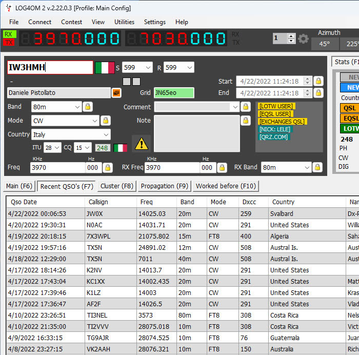

Cris, you might consider HamLib.
Not sure if you are running slicemaster for the flex but its a great program. There is a Log4OM readme file in the zip file that shows you how to connect the Flex to Log4OM with HamLib. It will make both VFOs work and Log4OM will log whatever slice is set to TX.
My only complaint is you need to start the programs in order. Flex, SliceMaster and then Log4om.
Rich

Have you downloaded and installed SliceMaster?
In my setup that's a required component. There is a Log4OM file in his installation zip file giving step by step instructions.
Rich

yes i have downloaded slice Master now all ok it works THANK YOU for helping me
Re: frequencies of the 2 VFOs
You are welcome. Hamlib works better than OmniRig in my opinion but as I said needs started up in the proper order to get to work.

I notice that 'slice b' was not change to be B, but was also A
Dave ve3wej / ve3ie

mine works, so not log4om issue check smartcat again
