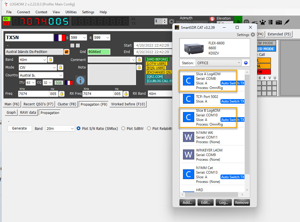

Only way to do that is to assign rig 1 and rig 2 in OmniRig to the two Flex CAT connections, thats one of the reasons why I sold my flex and went to SunSDR with the excellent TCI interface
Re: frequencies of the 2 VFOs
G4POP wrote: 20 Apr 2022, 22:33 Only way to do that is to assign rig 1 and rig 2 in OmniRig to the two Flex CAT connections, thats one of the reasons why I sold my flex and went to SunSDR with the excellent TCI interface

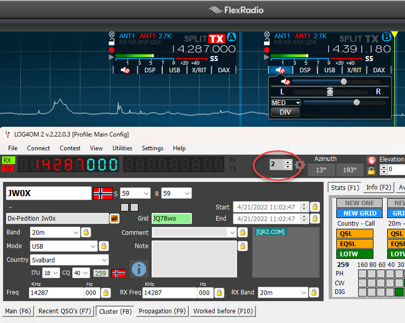

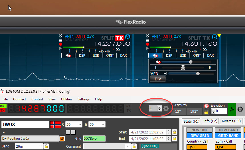

That doesn't seem to work Terry. It should, but I have yet to make that function. SmartSDR cat shows OmniRig connected to both ports/slices but Log4om still does not seem to work.

It does if you switch from rig 1 to rig 2, or it did for me when I owned a Flex
Dont expect to see both VFO frequencies at the same time you need to switch in Log4OM
Terry will not switch on mine. I have had a few times over the years where both VFOs actually showed up momentary but did not last and that was encouraging. But I cant switch back and forth.
This is not a Flex issue. This is a log4OM issue. The slices are on 2 different com ports. HamLib works so much better for the Flex but you have to start all your software in a certain order. Doing all this testing I got tired of shutting down everything and restarting.
I am sure its capable of doing both slices on the Flex if Lele would choose to.
Rich
Note selector on both images and which slice shows up in Log4OM
