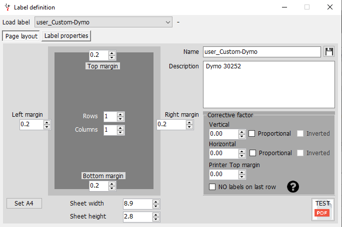

Today it took me a few seconds to print labels using Dymo 450, I'm using address label 30252 just set the sheet width to 8.9 & sheet height to 2.8, and (for sure row 1 & columns 1)
and you will be all set

This is a screenshot of my setting

9k2hn wrote: 30 May 2022, 03:43 This is a screenshot of my setting
Hello 9K2HN for your replay.
How did you fill in "user_Custom-Dymo"?
I can not find anny dymo printer in the label definition.
For the Dymo i have the programm from the Dymo website.
With kind regards: Henry Bolster PC2KY
Re: Single label printer
Type your chosen name into the field labelled 'NAME' and click the save icon to the right (Floppy disk)
